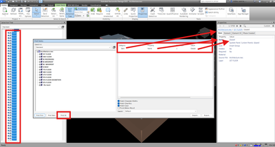

I have a model where i am looking to export out the items to a csv file.
when i select all the items in the selection tree it only selects the top of the hierarchy so none of the items appear.
is there a quick way to expand the hierarchy  so the item below it appears in the dropdown menu and then when i select all it picks up the information?

Hello @sagnewYUXLR , I hope you are well, it occurs to me that you could check in that level of geometry that you are interested in looking for some parameter or data in common that allows you to filter the elements in a selection with the Find Items tool and some rule that you give to Navisworks:
To give you an example, in the example I show you, I found that a common data for these elements is the name in the Item tab, so, I will create a rule based on it:
So it tracks and selects all the elements that share the same data and now I can save it in a selection set:
and you will be able to export them to a CSV:
I hope you find it helpful, greetings!
