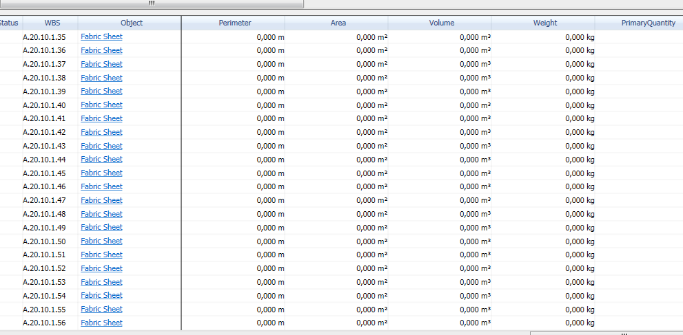

Hello guys!
He's doing a bit of testing with Navis and I realized that when I go to compute the amount of "Fabric Area" for Fabrci Reinforcement, the values of quantities are not counted, or rather are counted all ZEROS!
and the same with export in excel.....
yet the amount of the individual elements are present!
33.PNG where is the problem?
Thanx all!

It sounds like you may be running into the issue described in this article:
Quantification shows all values as "0" when using a non-English version of Navisworks
