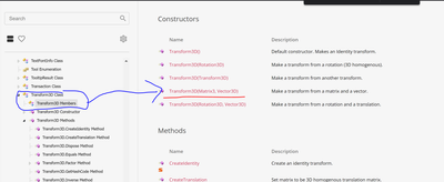

I also found that such transformation can be achieved with
Transform3D(Matrix3, Vector3D)
method which accepts a matrix:
I am not yet sure if it is required to check how work with matrixes but looks like it is a 3 by 3 matrix:
