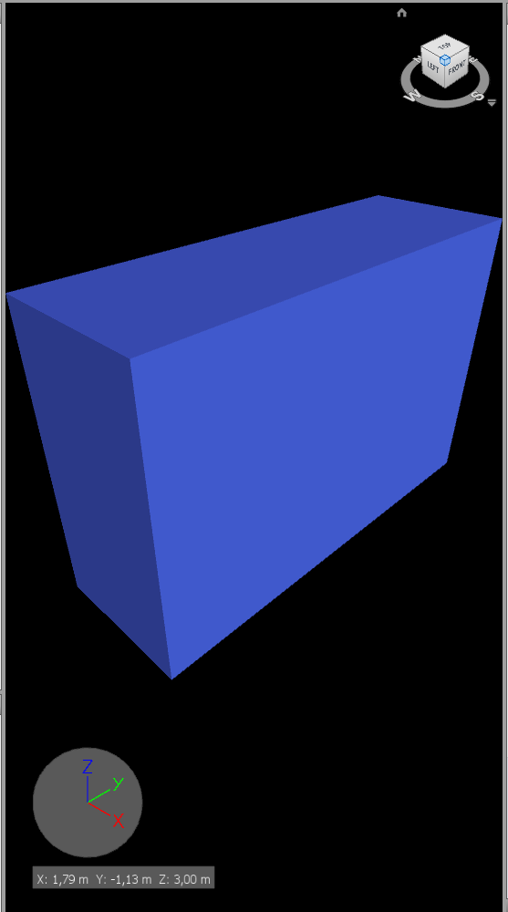

When clicking on the faces, edges or corners of the view cube, navisworks window reframes to fit selected object on the screen.
I am trying to trigger that behavior using the API when the selection changes.
I couldn't find any API reference that seemed able to call the view cube functions directly, besides I'd like to let the user specify the reframing ratio (by default the view cube fit the selected objects to the entire window which often makes the context hard to see, 1/2 or 1/3 window would be better). I did find the TopLeftFront function of the View object but it seem to only reset the scene.
So I started writting my own function, using the viewpoint object and the modelitemcollection.boundingbox function to get the selected objects dimension.
After some intensive trigonometric geomery, I am now able to replicate the "edge click" and "face click" functions of the cube, with nice parameter for fit ratio and view angle.
The "corner click" functions however has prooven to be a challenge of another level entirely.
I welcome all suggestions on how to create a "TopLeftFront" view of selected objects that would fit the screen on a given ratio (vertical or horizontal, whichever is the largest).
attached is an example of the view cube fiting, the ratio being always 1.

Message 7 of 9
ngombault
Sorry if it wasn't clear enough.
basically I am trying to fit the bounding box of the selection on the screen so that:
- the dimensions of its projection on the screen divided by the screen dimensions are inferior or equal to a given ratio (Hb/Hs <= R AND Vb/Vs <=R), and
- the bounding box projection is centered both horizontally and vertically on the screen.
when looking at the bounding box from the FrontTopRight corner, the longest dimension of the bounding box projection horizontally is generally given by the projection of the vector AC, but it can be AB or BC with very high FOV. Vertically it is generally the vector BiD but it can be BiB with high FOV (try it out in Navis with the vew cube, a dummy rectangular box (see attached nwd) and a high FOV like 120-140).
These conditions will give you a minimum distance to be away from the object AND the position both vertically and horizontally, which does not conincide with the center of the box (again try the view cube in Navis and see where the pivot point of the rotation is once the object is reframed, it is not the center of the box).
Since we know the coordinates of all points in the 3D space (X,Y,Z) we can calculate the coordinates of these points in the screen axis system, by using 2 rotation matrices, one around Z (angle teta) and one around X (angle phi). It gets a little tricky after the first rotation, since the rotation axis of the second rotation is X (1,0,0) BUT expressed in the rotated axis system (cos Teta, Sin Teta, 0), and that gives a nasty second rotation matrix. Wikipedia being allknowing, it also knows the coefficient of the second matrix.
I am sure having a lot of fun doing all this, but a more straigh forward solution would be appreciated. So I definitly vote in favor of the view cube API.
Regards,
Nic
