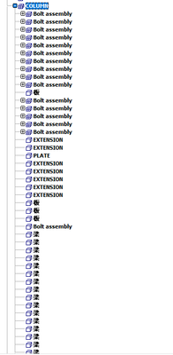

I am getting this error while trying to get Display Name of category on some objects in a file.
Fatal error. System.AccessViolationException: Attempted to read or write protected memory. This is often an indication that other memory is corrupt.
Repeat 2 times:
   at <Module>.LcOpPropertyNode.GetAttribClassUserNameFast(LcOpPropertyNode*, Int32, LcUWideStringBuffer*)
   at Autodesk.Navisworks.Api.PropertyCategoryCollection.GetAttribClassUserName(Int32, System.String ByRef)
   at Autodesk.Navisworks.Api.PropertyCategory.get_DisplayName()
   at CleanDups.navisInjectService.deletecheck(Autodesk.Navisworks.Api.PropertyCategory, Autodesk.Navisworks.Api.ModelItem, System.String)
   at CleanDups.navisInjectService.injectAttributes()
   at CleanDups.Program.Main(System.String[])
 the full program stop working when it hit that error and i can't catch it to skip or do anything when it happen.
my Code part
foreach (PropertyCategory oPC in modelItem.PropertyCategories)
    CatName = oPC.DisplayName;
is there another way to get the display name using Managed code or COMAPI?

barasalah
Thank you for the reply
it happens when i have weird data like this only
this is tekla ifc file
i can't share the file sorry.
using combined name instead of display name solved the issue
CatName = oPC.CombinedName.ToString();
