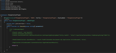

I compiled the following code and then placed the compiled files into a document within the plugin document.
using System;
using System.Collections.Generic;
using System.Linq;
using System.Text;
using System.Threading.Tasks;
using Autodesk.Navisworks.Api;
using Autodesk.Navisworks.Api.Plugins;
namespace ChangeCouleurPlugin
[PluginAttribute("ChangeCouleurPlugin", "ADSK", ToolTip = "ChangeCouleurPlugin", DisplayName = "ChangeCouleurPlugin")]
public class ChangeCouleurPlugin : AddInPlugin
public override int Execute(params string[] parameters)
Search search = new Search();
search.Selection.SelectAll();
search.SearchConditions.Add(SearchCondition.HasPropertyByDisplayName("Entity Handle", "Value").EqualValue(VariantData.FromDisplayString("C0A4")));
ModelItemCollection searchResults = search.FindAll(Autodesk.Navisworks.Api.Application.ActiveDocument, false);
Application.ActiveDocument.CurrentSelection.CopyFrom(searchResults);
return 0;
After completing these steps, I attempted to open Navisworks but encountered a pop-up message that refuses to disappear.
Is the problem with my code or is there another issue?

No, it will not work. I just tried it and encountered the same problem.
Here is a picture of the code that I loaded.
Message 8 of 13
jabowabo
Are you targeting the correct .NET framework (v 4.8 for Navisworks 2024)?

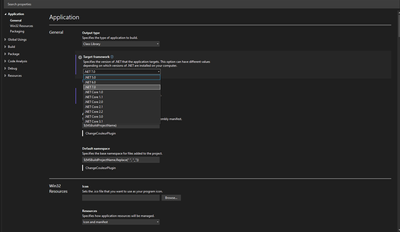

I was previously using the .NET 7.0 framework, and now I'm attempting to switch to a different framework in my project. However, the .NET4.8 framework is not appearing in the list of target frameworks in Visual Studio Community, despite being downloaded on my computer. Do you have any ideas why it is not showing up?
Message 10 of 13
jabowabo
You created your project as a .NET Core project. You'll need to re-create it as a .NET Framework project and target version 4.8.
