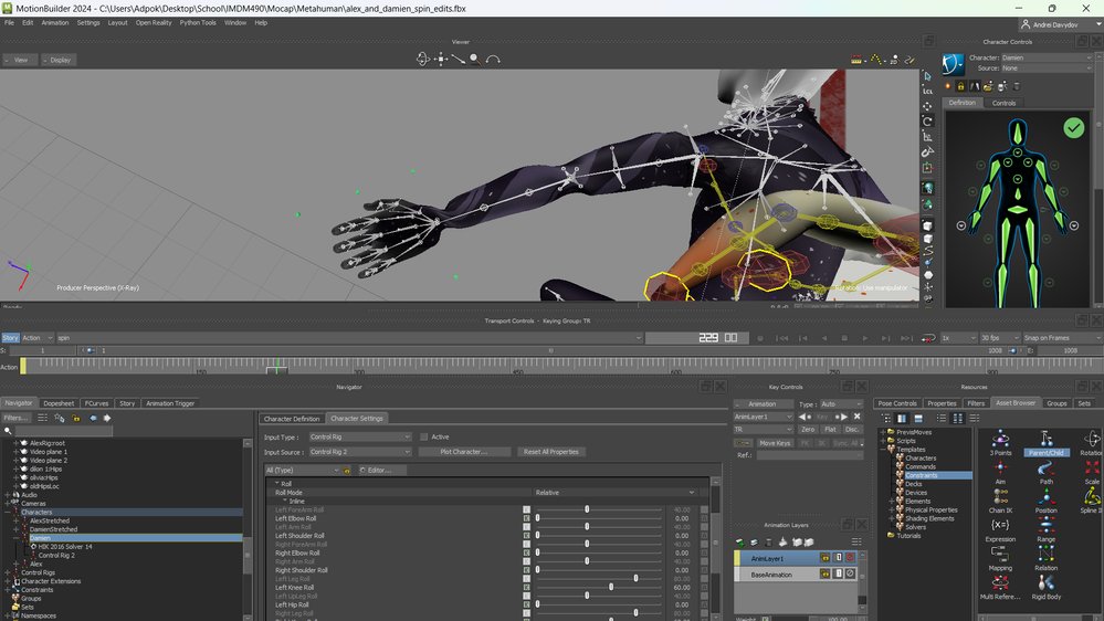

Hello, I was making some edits to my mocap animation (fixing the hand rotation). Despite having my twist joints set up, I still sometimes have this issue of the arms/ hands twisting like a candy wrapper, which you can see on the hands. I thought the twist joints would automatically compensate for the rotation, and trying to rotate the elbow or shoulder with IK Blend turned on for them doesn't seem to help untwist the arm. What would be the best way to fix this issue?

From the picture you posted, it looks like you're currently editing the control rig animation using the "Selected Effector" manipulation and keying mode.
With this mode, twist joints don’t automatically compensate unless they are explicitly selected and the Blend T value is not set to zero. This might be what's causing the “candy-wrapper” twisting effect you're seeing in the arms or hands.
For the twist joints to work properly as defined by the Roll Mode property in the character settings, you may have to switch the manipulation mode to "A Part of the Body" instead.
Also, it’s possible that the rotation is being unintentionally constrained by the DOF (Degrees of Freedom) settings on the FK effectors. If those limits are enabled, they might be preventing the arm from rotating freely, which could be contributing to the twisting issue.

If you characterized roll bones from MetaHuman skeleton, make sure to use Leaf mode instead of Inline.
MH rig has leaf roll bones set up, not inline.
In Motion Builder, Inline setup will not only twist your roll bones but your elbows/knees as well unless you check the Kill Pitch option as well, under Modifiers from character settings.
In general I would not use MB roll to keep control rig rotations as simple as possible, then set up my own roll bone with constraints like in UE. If you need help on setting up roll bones outside characterization just let me know.

Hi Andrei.
Here is a sample file with a simple HIK ctrl rig and custom roll bones constraints on top of it.
The goal is to get your core control rig as simple as possible so it will be easier to share animations between projects. In general you don't want to get any roll bone on your core motion so it can be reused on any skeleton without having weird twist on wrist, elbow, shoulder, knee...
You have to dissociate parts of you rigs that drive your animation and that drive your deformations.
Roll/twist are not driving your animation but driven by your animation and affect the deformation of your model. So they should not be part of your animation pipeline but only on your deformation pipeline.
Making your source animation data simple and consistent will save you tons of problems down the line.
As for the custom roll bone set up, it's a simple relation that interpolate between a single IK chain with no pole vector and the actual skeleton rotation, for instance between shoulder IK and arm bone. It's a kind of old way to extract twist and swing quaternion.
This rig is fully generated by script. I generally start from a raw mocap using VICON or Xsens then run one script that fix extra twist on elbow knee of the core skeleton then another one to generate that control rig and export character animation result. It's part of a large mocap automation system.
That auto rig system is also used for character design iteration to quickly check character range of motion capability.
This control rig has adjustment on Pre-Post rotations to get a full mirror behavior unlike the default control rig and has optimized display feedback. Stick look is much slower that the box look so it help when you have many control rigs on a scene.
For your Meta Human character, you should do the same. Keep the characterization to minimal without roll bones and set up your roll on top of it.
