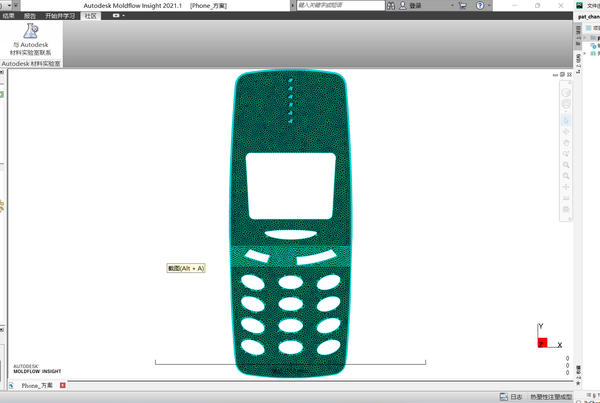

I want to use a script to close the page below, how to write this script

bernor_mf
@1292909313
If understand you correctly, you want to close the study.
This example closes the active study.
SetLocale("en-us")
Dim SynergyGetter, Synergy
On Error Resume Next
Set SynergyGetter = GetObject(CreateObject("WScript.Shell").ExpandEnvironmentStrings("%SAInstance%"))
On Error GoTo 0
If (Not IsEmpty(SynergyGetter)) Then
	Set Synergy = SynergyGetter.GetSASynergy
Else
	Set Synergy = CreateObject("synergy.Synergy")
End If
Synergy.SetUnits "Metric"
Set StudyDoc = Synergy.StudyDoc()
StudyDoc.Close
If to close more open studies, you need to loop the command.
If you get an error, it means no study open, and you need error handling.
Hope this helps.

1292909313
Sorry, I want to close this window
bernor_mf
@1292909313
First, if changes has been made to study, it should be saved.
Otherwise a dialog will appear "Save changes to study_name?".
Code:
StudyDoc.Save
Might need to add a wait for save to complet such as:
WScript.Sleep 3000 '* in ms, so a wait of 3s
You are using Autodesk Moldflow Insight 2021.1 , and to close the window:
'* Closes all windows with title
Dim oShell
Set oShell = WScript.CreateObject ("WScript.Shell")
'* You are using Autodesk Moldflow Insight 2021.1
oShell.Run "taskkill /fi ""WINDOWTITLE eq Autodesk Moldflow Insight 2021.1""",0,False
Hope this helps.
Regards,
Berndt
( If my comments are accepted, provide "Kudos" as appreciation. If your request is answered/resolved, please click the "Accept as Solution" button. Thanks.)
1292909313
Thank you very much, my problem has been solved
