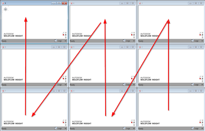

when arranging windows in synergy its difficult to handle more than 2 windows.
sometimes i have to compare 6 or more options and its very difficult to order them in a nicely manner.
to move them around manually results in not alligned windows
for this a function would be nice to lock windows into place or to allign windows automatically to the neighbor windows (as f.e. possible in powerpoint)
or switch positions around. f.e. you "tile" the windows and you are not happy  that window 2 is at position 4
a function to swap the position of windows would be nice > click window 1, window 2 >positions are swapped

Hi @timotheusruf  and @bernor_mf ,
Split is happing on the opening sequence of the opening studies..
the first one is appear at the right bottom corner next one is upwards to the end of windows and after that to the left side repeating same sequence.
Regards,
Anirudha D
timotheusruf
yes @adevadkar and thanks
and when you click tile again, the last activated window will be moved to the upper left corner
and when activating another window and click tile again, the activated window will be moved to the upper left corner and the former window will be moved one position below in the pattern you described.
to know this is helping when arranging windows, but it can become quite a mini game puzzle if you want a certain order.
therefore a function to arrange (as described) or lock windows in place when moving windows around would be nice
