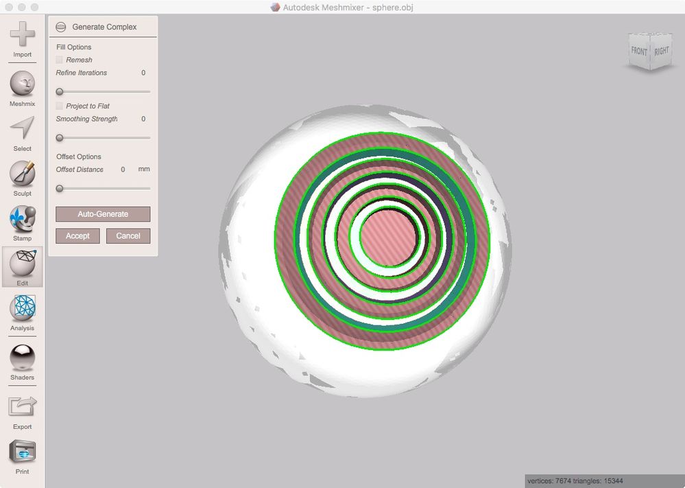

Dual color printing or more colors?
If there are several concentric square groups and you want a dual color print:
Do not use AutoGenerate. This spans an interior surface over the outer seam of the group (same as if you'd double click on each boundary which gets orange hovering over the boundary)
Instead hover the cursor over a group > The whole group gets orange. Double click it > This results in an offset interior surface (as if you'd extrude the group to the inside). Do this with each second group...
Message 6 of 12

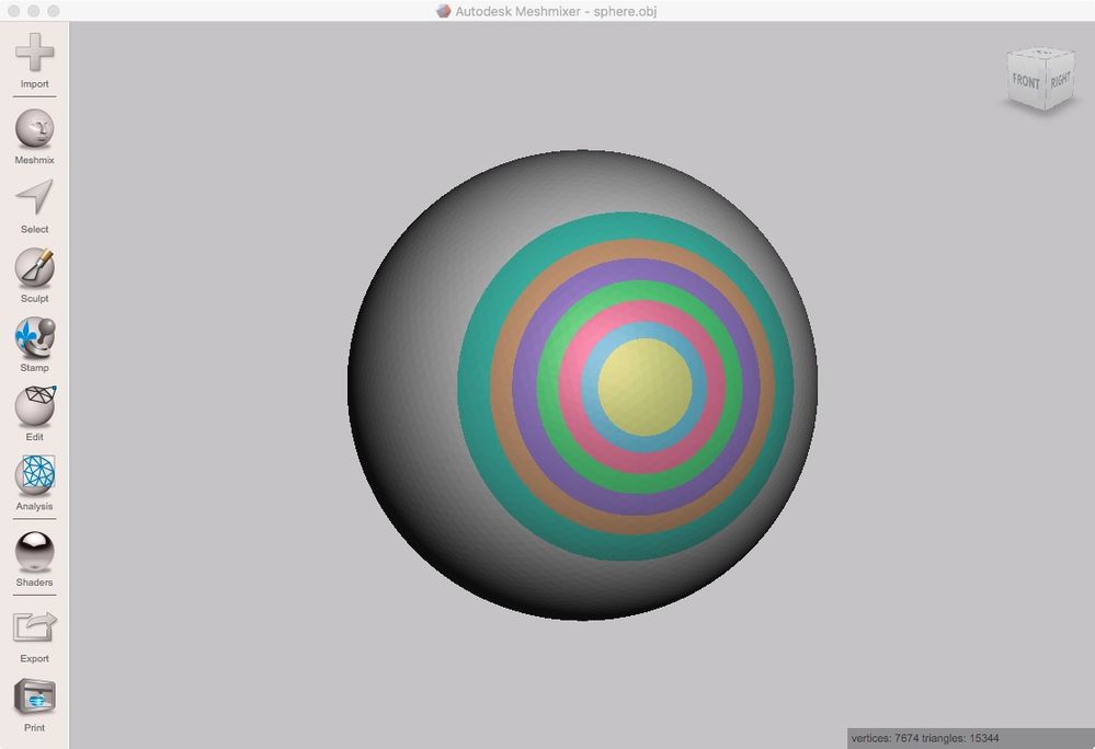

Some images:
The groups:Ohne Titel 3.jpeg
After double clicking the cyan, purple, red and yellow group in GenerateComplex:
After splitting the complex and combining the regions to be printed in red (transformed for visualisation):

I made the concentric rings using a circle STAMP. To get the center point of the rings I dropped a Pivot somewhere on the surface. Now drawing a stamp and starting to drag near the pivot the stamp's center snaps to the pivot.
Be aware of the SnapDimensions checkbox at the bottom of the tool's flyout. Enabled the possible sizes and rotation angles are restricted to certain increments. The increments' scale is related to the last used snapping settings in Transform (but not equal).
Start stamping the biggest diameter flowed by the 2nd biggest, aso....
To get a rectangular group you might use the square stamp or create a custom stamp in SELECT.

The Complex tool renders valid group boundaries in black. In case there are two options of a valid boundary but both are not possible (as in your case) MM chooses the group with the lower FaceGroupID. In your case: White is the group "zero". All other groups get their number by history. The first group you create gets something like "1" as ID, the second "2" ....
To change the behaviour of which group boundary is treated as valid in case of a conflict you simply need to change its order. In your case: Select the white group (ID = "0") after you did the orange (ID = "X")  and do Modify/CreateFaceGroup. This creates a new group (ID = "X+x" - means done after "X"). Now the Complex tool will highlight the boundary of the orange group and create the interior surface there.
