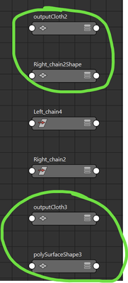

anyway looking at your maya file i can not see it there and the hard edges in painter seem to be caused by the same problem why your uv´s don´t show up correctly. left and right chain have some left over shape nodes from your cloth simulation which survived history deletion. you can see it in the attribute or node editor. e.g.
if you delete those shape nodes which are not connected to anything here you should be good to go

joebranch
Aha! Thank you so much that's solved the problem! I have spent days trying to figure this out!
