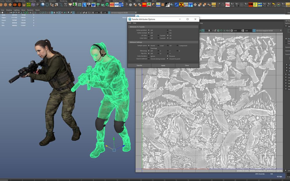

Hello everyone,
Can someone tell me what is happening with my model?
I have a model with texture. After applying the remesh and retopology UV is disappearing. It looks like I can't apply UV at all.
Does anyone have an idea what I did wrong?
Thank you in advance!

remesh creates a new mesh, you lose the UVs, you’ll need to do  a UV transfer from the original.

maleforsaling
Thank you for the reply!
Actually after remesh UV is visible and is working. Just after using "retopology" UV is not working. I tried to transfer. Did not help

Actually it doesn't because I'm using retopologize
Message 7 of 11
damaggio
You said the transfer didn't work but without explaining your steps and settings I have no idea why it didn't work, You have to explain better when you reply.

Selected the model with UV and later without -> Mesh -> Transfer attributes -> Transfer.
Settings as on the picture below.
Message 9 of 11
damaggio
Thank you for your image settings Mal, I think that the Component option is better or designed for Transferring UVS to a duplicated mesh with the same vert ID numbers, for Retopo, try in World space as I did here with a military scan and it worked fine.TransferUVS.jpg

maleforsaling
Thank you so much!
World space worked partly. Transferred but orientation was wrong. But with option "Local" it worked just fine!
