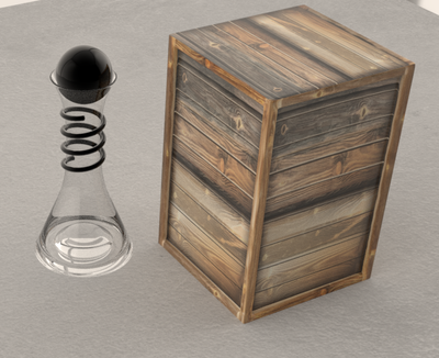

You gave a lot of detail. Even though it's not my question, I was wondering the same thing. I am a student and rendering an assignment. It took 2 1/2 hours to do 30 frames out of 120. Fairly simple items (This is my first modeling class). I have an I7 processor with 16G of RAM. Following a video on YouTube it was suggested to use my GPU to render. Could this be a factor in the speed of the render? I am attaching a pic so you can see what I was trying to render. The stopper has a 120 frame animation removing it from the top. Pretty simple. I textured the crate with PSD file, maybe that is part of the problem? Any help you could give would be greatly appreciated @Anonymous .
Tracey
