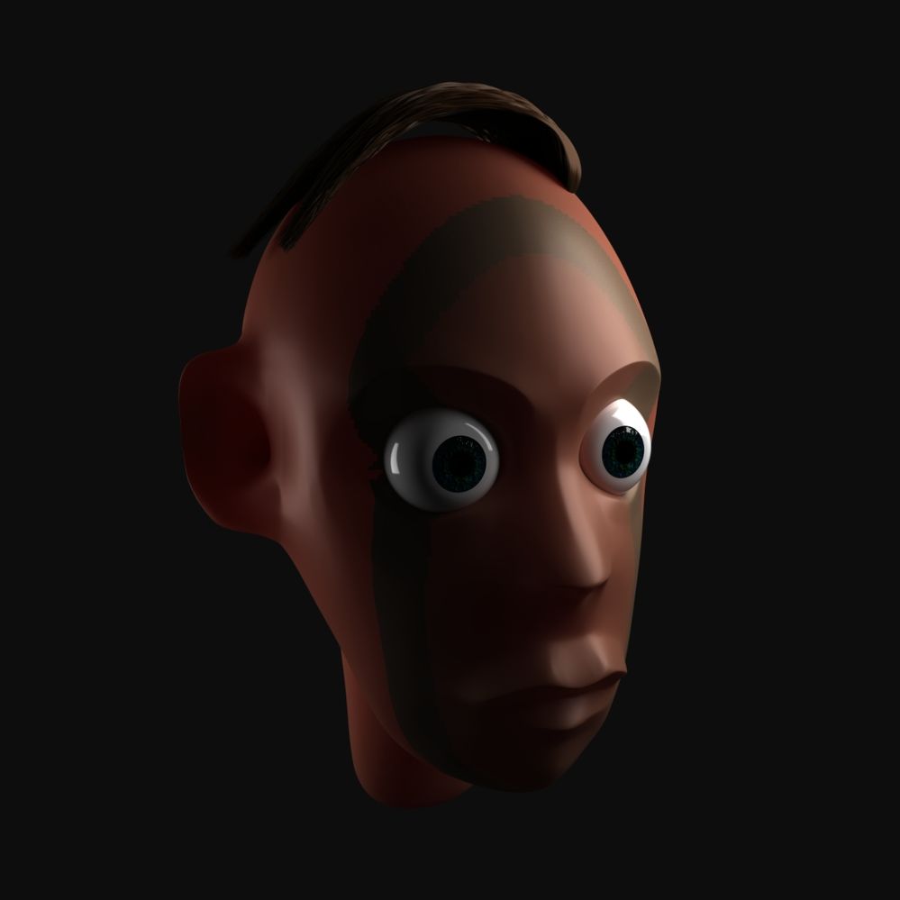

Saving rendered image problem.
3,876 Views
First screenshot is of the rendered image inside maya.
Second screenshot is the image saved from File > save image.
It gives red color and the skydom light is gone in the saved image.
Also I'm getting that dark circular band around his face, the head was imported from zbrush.
3,877 Views
kollig
You have to switch to "Save Color-Management Image" using the option box behind the "Save" item.
I enabled color management in save image options in render view, problem still persists, I found that changing the value of gamma in render view gives the save image as that of the render output image, I think it's because of gamma? How can change gamma in final render?
faline.custodio.da.silva
@Anonymous
I found this article really helpful with it comes to color management and linear workflow: https://community.renderman.pixar.com/article/1206/linear-workflow-color-management.html?l=t
There are great screenshots in there. Hope this is helpful to you!
Cheers
Faline Custodio Da Silva
Thanks! It worked, read the article, made a few tweaks and it was all good.
