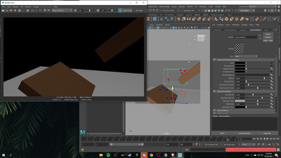

nParticle render using Maya Software
 My nParticle is not showing my in Maya Software redering. What is the possible solution?
Thank you

Quite possibly, the shaders have too much transparency. npPointsBlinn rendering sample looks suspiciously empty, try to break connection to its Transparency texture.
Besides, in the screenshot Maya obviously warns you about some kind of error - I dare you to read those.
