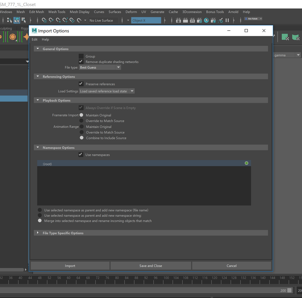

Trying to move a project from Maya LT to Maya (finally upgraded). Due to the polygon export limit on LT, I broke up everything logically and exported out the FBXs with embedded media to preserve materials. Then i copied all the texture files into the new SourceImages folder. Everything is working ok, but every time I import an asset it duplicates the material if its already in the scene. Is there anyway to stop this from happening? I just want on M_ChairPlastic material, not one for every time an asset with that material gets imported. So any way to tell maya to merge these materials on import or after the fact would be extremely helpful. Thanks in advance.

Hi Alex, in the import options there's a checkbox for Remove duplicate shading networks. try that again.
Message 3 of 19
Thanks for the advice, I did try that however it just duplicates the material in ...001, ...002 fashion.
Message 4 of 19
damaggio
Use these settings...
Message 5 of 19
CurrentImportSettings.PNGLooks like we are on the same page. It still duplicates the material on import.

If using Embedded Media this will (can't) work, because when importing the file, each files media content will be extracted to a separate temp folder, so the file paths do not match and the shading networks can't be merged.

Hi!
Simply don't use "Embed Media".
As long as the whole network and all paths are identical, merging shading networks will work correct.

Hi!
If it doesn't work then there is a difference somewhere in the networks.
