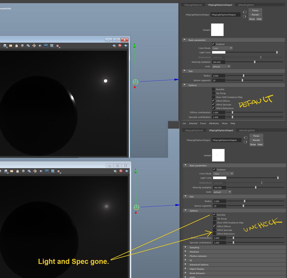

Hello fellow Maya users.
I was wondering if there is a simple way to remove  a light from the environmental fog (for example a rim light)
In arnold it's as simple as zeroing the volume samples but can't realy figure it out with vray.
Any help appreciated!

I did assign the fog to the containers shading group. I made the light in question have no effect on the container. It's excluded from the fog but the make invisible chceckbox has no effect. Screenshot attatched:

Vray fog, displacement,object properties and other features work inside of a set, just look in the outliner, there's a plus sign where you can see objects inside the set , I would not use a container for fog, just drag your light inside the environment fog , those will be affecting the fog,
read the docs again , I think is self explanatory  there.

Hello and thanks for your detailed explanation.  The chaos group forum is read only, I'm waiting for my account approval 🙂
Ok so I didn't mention  that I used the environmental override to create the environmental fog, then tried the solution with the container. There aren't any lights in the dropdown menu when using the solutions I just mentioned.
When I create  the vray environmental fog on it's own (via hypershade editor) then drag and drop the lights in the outliner it simply doesn't work (i guess it doesnt know what to affect?) Is there a way to force the fog to use custom made light set instead of the defaultLightSet present in every scene? I would like the sphere light to add reflection to the flying soucer only, but not be affetced by the fog at all.

Both of the lights are still visible. Changing the light mode even to "no lights" has no effect on the scene whatsoever

Me again. It worked but only if the fog is applied in the containers shading group.
