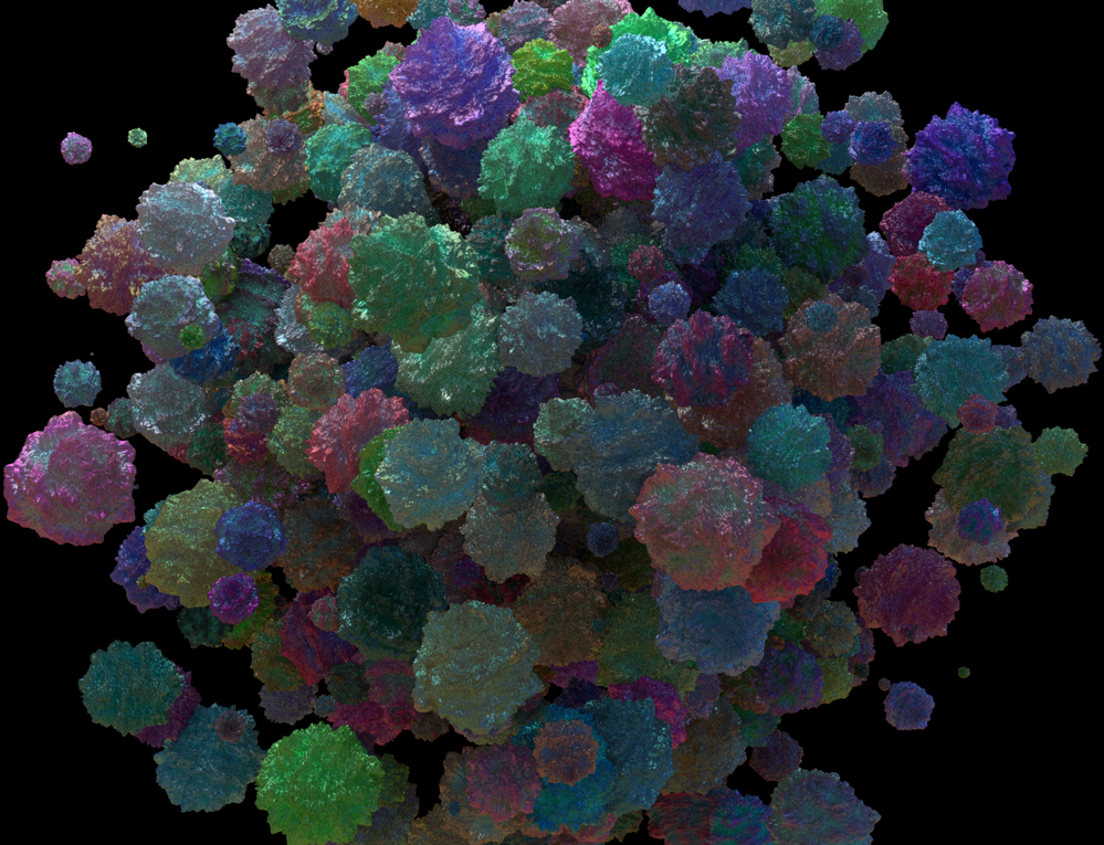

It's not advisable to have the original object that was exported as an archive in the same scene as the xgen description using those archive objects. This can cause the material bindings to the archive objects to get overridden.

Thank you for the reply Michael,
Those images look fantastic. I managed to get it working myself now as well. I was also just wondering can animated displacement maps work with xgen archives?
