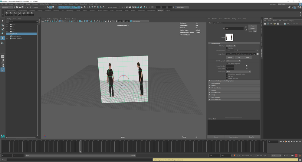

I can't seem to make this image sequence play with the time line. I have the correct naming convention (drunkSeq.0001.tga) and can see the texture in the render view but the sequence is not playing when I hit play. Is there an expression that is supposed to be linked to the image sequence number? How do I fix this? Any help would be great!

Hey, this should work out the gate. But in the image you uploaded it looks like your "Image Number" on the file node has no expression plugged into it.
By default when you check "use image sequence" an expression will automatically get plugged in. It's no biggie to fix. Try recreating the file node and see if that box changes color, to indicate an expression was linked to it. If not, also not a big deal, but you'll need to know a little about creating expressions.
Right-click "Image Number", select create expression. In the dialogue that pops up you want to enter the following into the "Expression" feild:
NODENAME.frameExtension = frame;
Node name - this is the name of your image node and you will have to enter it manually
frameExtension - this is the real name of the "Image Number" attrib
frame - this is how Maya knows to take the current frame number and make this expression match it.
After all that the box should change color indicating an expression is connected and everything should work!
Let me know how it goes!
Ah that's fixed it! Thanks so much, for some reason my Maya is not creating this expression for me automatically.
Thank you 😄
