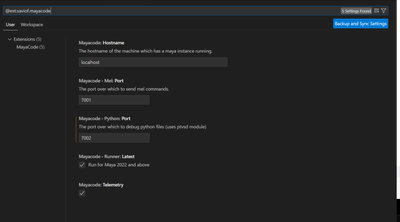

Quite easy to fix:
Just make sure you set the ports right in your MayaCode Extension settings:
Then execute following python command in maya:
import maya.cmds as cmds
cmds.commandPort(name="127.0.0.1:7001", stp="mel")
cmds.commandPort(name="127.0.0.1:7002", stp="python")
worked for me.
