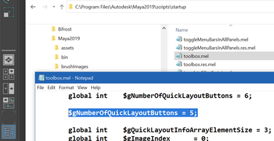

I was able to change the number of those buttons elsewhere:
However, possibly somewhere, even in the aforementioned userPrefs.mel, the specific (existing) layout should be assigned for the new buttons. The icon for the button can be changed from RMB > ChangeImage...

Message 5 of 9
phibonacciSequence
Had to enable administrator mode but it worked.  It's frustrating that Autodesk hasn't added (or added back) this feature without going through the program files, instead of for example: just right-clicking on an empty space in the left sidebar and adding it in Maya.

drbrandtjr
Hey hamsterHamster,
Thanks for that solution.  For us Mac users, do you happen to know where to find the toolbox.mel file?
I was lucky enough to find it in an old Autodesk_Maya_2016_EN_JP_ZH_Windows_dlm folder that I had hanging around.  I modified it according to your image above and moved it into:
it works!  But if it's not a file that is normally on a mac.  Other Mac users may have trouble getting it.  Contact me and I will email it to you.
