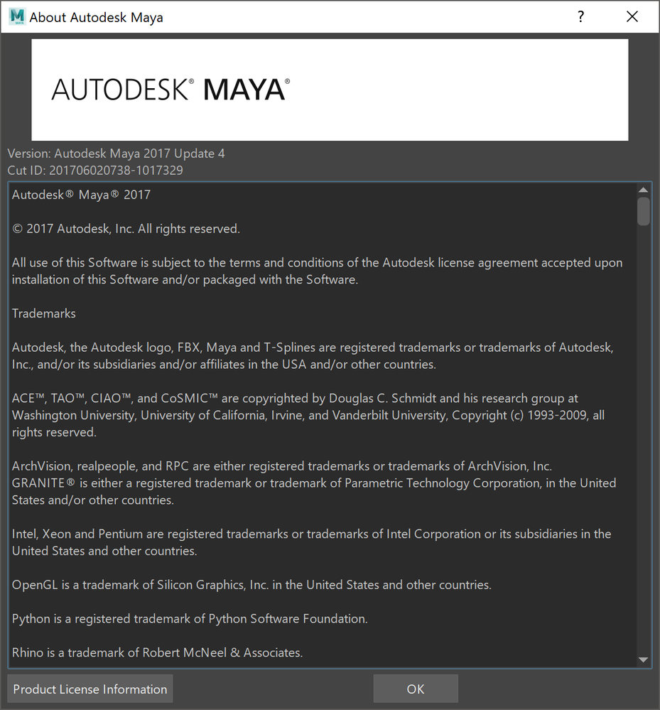

Hi Li,
Sorry for the late reply. Yes, I've tested with Maya 2018 and the issue is not there anymore. Seems it has been fixed at some point. I'm not sure of exact version of Maya 2017 I was using ( I mean what update ). How can I check that? I'm getting this from Help->About Maya dialog.
Kind regards, Mila.
cheng_xi_li
Autodesk Support
Autodesk Support
You could find update version in about box. Your screenshot shows an unpatched Maya 2017. The cut id shows it is built on 20160615.
