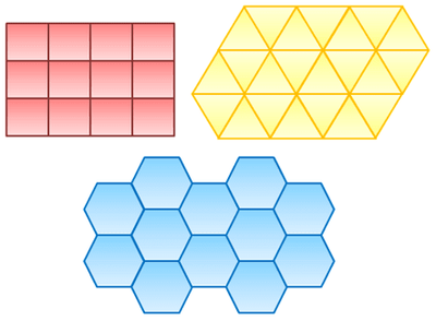

I'm not sure if that's the right place to ask that question but:
I'd like to compute the positions of a determined amount of points inside a circle (ideally an arbitrary shape). This points have to be equidistant (evenly distributed).
Thanks!

jmreinhart
I'm not sure what the vogel method is, unless you meant voxel?
There are three patterns you can use the create a set of points that are all equidistant from their closest neighbors.
You can see this when you are tiling a plane. If your points at are the center of the polygons, then they will be evenly distributed. You'd just need to choose a starting point in the shape, and then build out to each of the neighboring points and if those points are inside the shape continue the process until none of the points have neighbors that are inside the shape.
It might be easier/faster to get a bounding box for your shape and use that to quickly find all the points that would be inside that box and then check if they are in your shape.

The yellow tessellation (with triangles) would help. But let say you X amount of points inside that shape, how would you define the distance between these points. Do you think about a loop reevaluation until the X value is found?
Message 6 of 9
jmreinhart
Oh, that's a really interesting method. I've seen graphics showing flower seeds following that method to spread out evenly. Yeah unfortunately that method is only useful for circles. I think your best bet is creating a grid of points and checking if they are in or out. You'll need to iterate the distance to if you want an exact number of points inside the shape. Iterating until you get an exact number of points might be slow (if you have lots of points) so if you just want a result that looks right you could put in a distance have it generate the points inside the shape, and then you could decide if you want more or less and adjust the distance manually.
