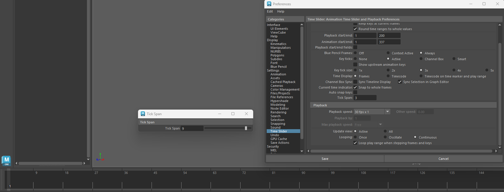

You can change it by dragging and undragging the slider or entering a number.
The Preferences do not reflect the numbers, but you can see that the UI controls them.
UI controls tick spanUI controls tick spanUI and Preference, the preferences do not reflect the numbers.UI and Preference, the preferences do not reflect the numbers.
