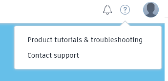

golaem
Here is mine (for the golaem account)
