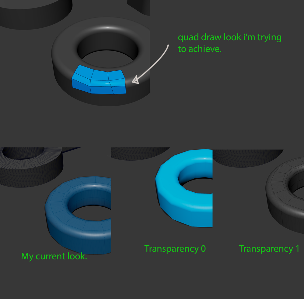

I'm building a maya retopology tool and i'm trying to get a viewport look similar to quad draw.
What i want specifically is the same visual result quad draw has where the wireframe overlay is above the material.
Since my retopologised mesh occupies nearly the same space as the source mesh, i had to use "alwaysDrawOnTop" with a semi transparent material. The problem is it brings the shading of the object over the wireframe rendering it useless. Is there a way to force wireframe to render on top of the object's shading without enabling wireframe on shaded globally? and maybe control thickness also?

This older post has information on how QuadDraw achieves that look.
https://forums.autodesk.com/t5/maya-modeling-forum/create-material-like-the-quad-draw/m-p/13757644#M...
You have already discovered the alwaysDrawOnTop attribute and the thick wireframes are handled by custom drawing in QuadDraw.

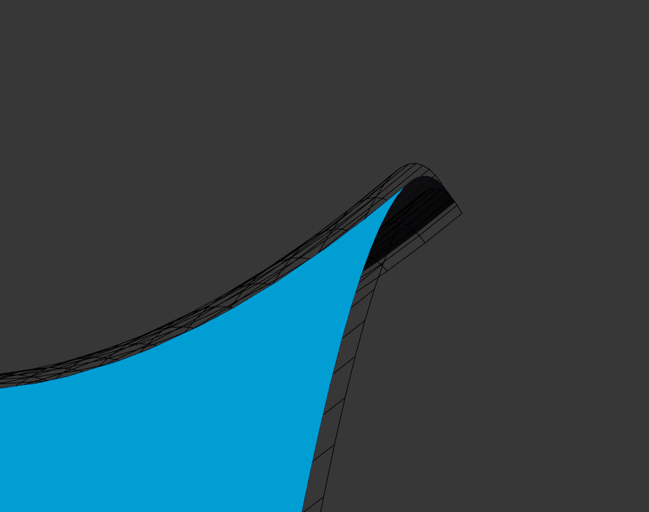

Hi Brent,
Thank you. I understand now that the wireframe is custom drawn and the mesh uses alwaysDrawOnTop. One thing i'm still trying to understand is the depth relation between the two. Are both (quad draw object and wireframe) custom drawn together or is the blue mesh a regular geometry with the wireframe only custom drawn on top? If the wire is custom drawn separately, how is it depth-sorted against the blue surface? Is it using MShaderInstance::setDepthPriority or a custom viewport ordering? Any guidance on the api path would be very welcome. Thanks in advance!

The two are drawn separately.
It has been a long time since I worked on this and I didn't work directly on the rendering aspect so take this info with a grain of salt...
The blue mesh (drawn with alwaysOnTop) is drawn with depth buffer trickery to appear on top of the mesh you are retopologizing with QuadDraw.
The thick wireframe mesh is drawn on top without depth buffering and it might be using something like alpha testing to handle self-occlusions.
This is done using a custom drawing mode that I don't believe is exposed via the API.
