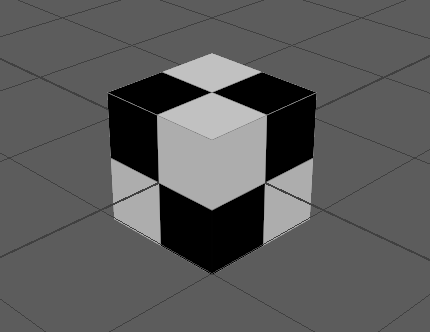

I'm experimenting with a simple C++ plugin which draws a shaded cube using a locator node with a geometry override. The shading is done by loading a fragment XML from file.
If "Consolidate World" is enabled, and I start transforming the locator node (e.g. by translating it), the shader stops working.
After loading it looks like this (see the fragment XML below):
After starting to translate the node:
The strange thing is that if I replace the mayaChecker in the fragment XML to mayaBulge, this doesn't happen.

Sorry for the delay. I think it is similar to a known issue which Pm value is unstable while moving the object. It appears that there isn't a workaround right now.

The problem occurs when the viewport uses OpenGL, it seems to work fine in DX11 mode. Unless your project(s) require OpenGL, maybe switching to DX11 could be a temporary workaround.
