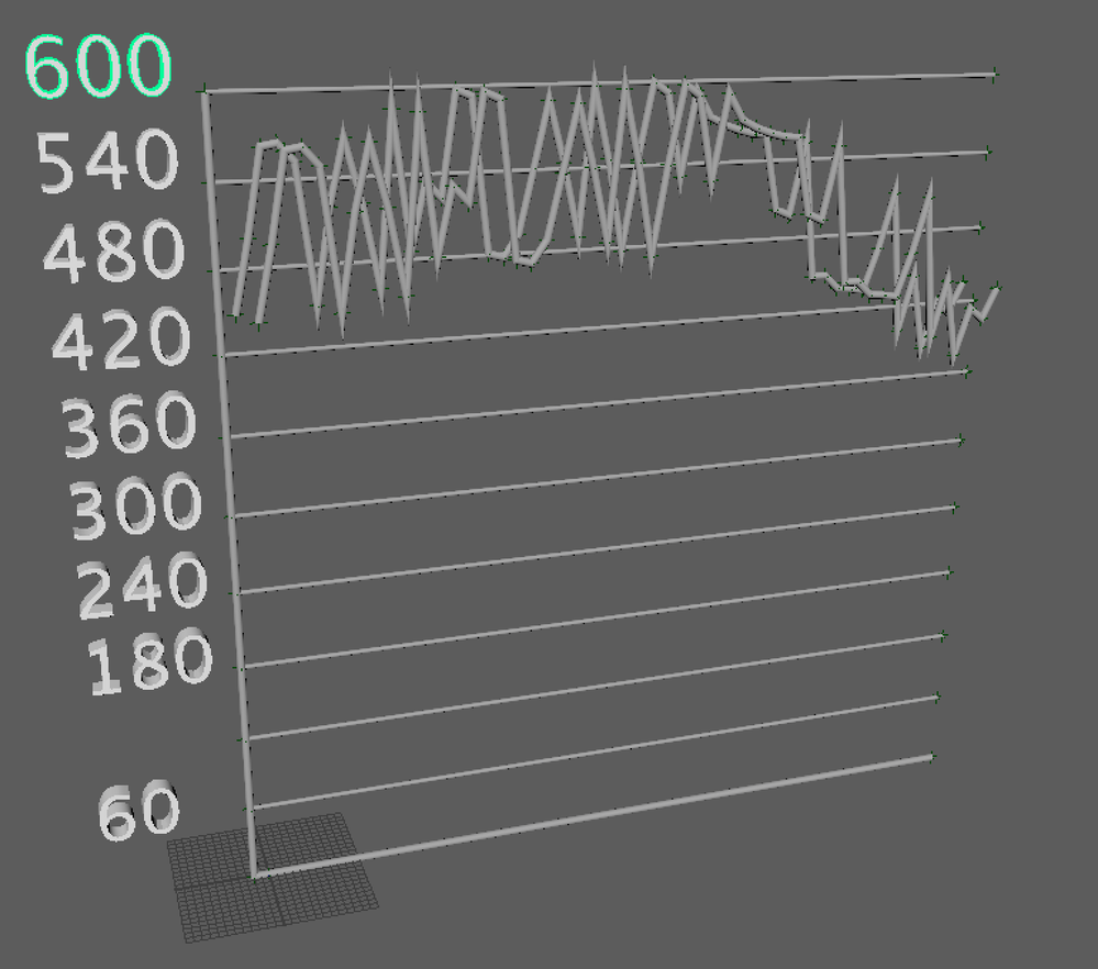

Here you can see the number 120 is missing after running my chart code twice, the selection of 600 is from it going over each text object after they were created. I think that I'm changing the contents of the text objects before maya has finished doing its text creation process and so having the program wait until it is done, then change things like font size and text would work better. If anyone knows a way to do this or understands more about how the type tool works please let me know.
