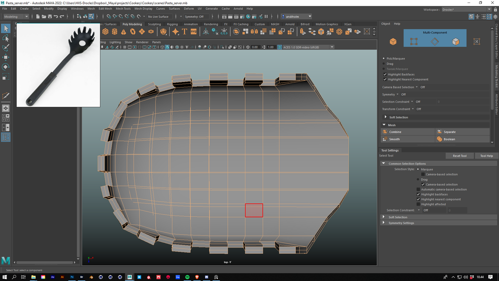

I can see the edges on the other side of a relative thin object
415 Views
1 Reply
Hi there
I can see the edges on the other side of a relative thin object, how can I adjust this?
416 Views
1 Reply
Reply (1)
mspeer
Hi!
Either move those faces or adjust your camera clipping planes (Near and Far).
