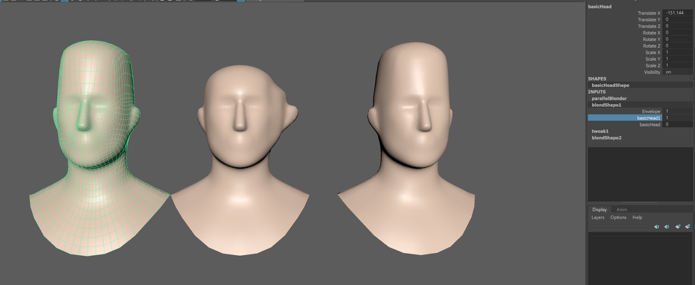

2) connect them to your original head using a blendshape:
deform -> blendshape
Now you're able to deform the original head to look like the various heads:

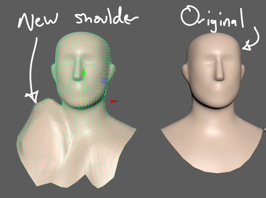

4) Take this duplicated head and model the neck changes you want to make.  In our case I did something crazy:

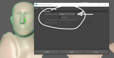

5) now connect the new neck to the original head with a second blendshape, but this time use the "parallel" mode under the advance tab in the blendshape options:
Doing so you'll get a second blenshape node on the original head:

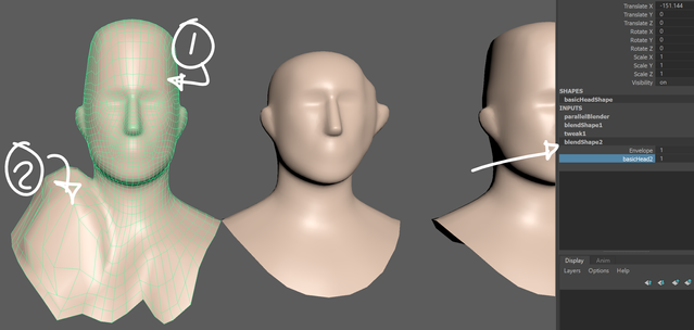

6)  you can dial each blendshape on for the first set of heads one at a time, and you can keep your new shoulder on in your second blendshape at the same time:
So you'll see in this picture I have the new crazy shoulder now combined with my super cool tall head guy.
7) Once you have each combo ready, simply duplicate the mesh and delete the history on the new mesh.  That will give you the new heads with the changes made all identically.
