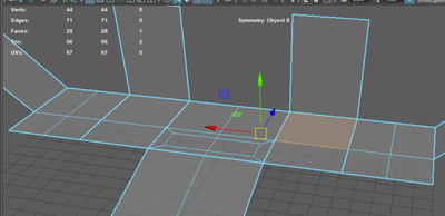

And what's wrong with this modeling thing when shift drag extrude and shift drag inset stops working ? When symmerty enabled ? I am also talking about it like forever ! Are you even looking into these problems ? Do you have some dedicated team ? YOUR MODELING TOOL IS BROKEN AND A MESS, it does not work ! It's not my imagination, I am not crazy or making this up ! look  at video files, in the first case shift drag does not extrude, it is dragging the whole model, starts working again only after cleaning history ! In the second instance symmetry is just broken without any reasons, how am I supposed to model with this ? Clear hostory every 3 seconds ??

Here I attached the zip file. You can check it out. in example 1 shift drag extrude isn't working. Just open the file, enable object x or topological summetry and then try to shift-drag extrude from any outer edge, it just won't unless you disable symmetry or clear the history and it does it all the time. In an example 2 same model and same the problem, but this  time with shift-inset. Try to inset any polygon, it won't, scales the whole object.

It appears to me that the polyEdgeExtrude might be the root of the problems.
Historically, there was no poly edge extrude initially, it is later addition, and never worked safe way to me - after edge extrude, the pivot of any selected faces relocates to random position, and that's why:
  • Symmetry might stop working in your example1.mb - as you do edge extrude followed by extruded faces;
  • the modeling method in the Youtube you were after is hard in Maya - the edge extrude transform gizmo is locked to normal axis (at least in M2019).
The pivot of selected single face (created by edge extrusion) is offset, which messes with SymmetryThe pivot of selected single face (created by edge extrusion) is offset, which messes with Symmetry
Therefore, I stuck to face extruding + Multi-Cut tool workflow, which works just fine.
