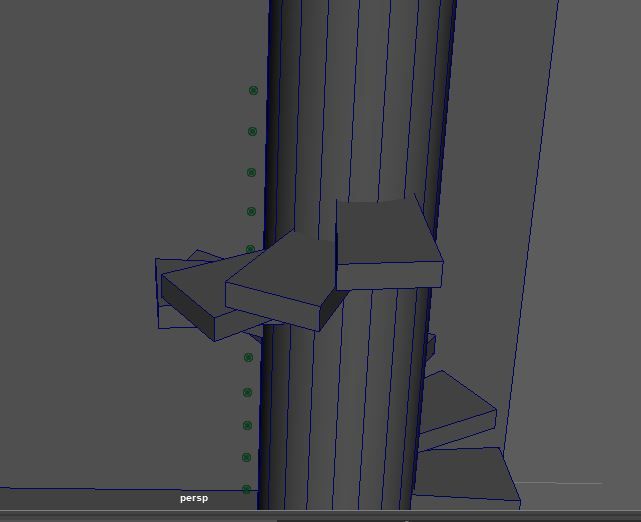

Hi. I am having this issue where green dots appeared and i don't know how to remove them. Sorry i am new to maya.Capture.JPG

Hi!
On some transforms you have enabled: Pivots -> Display Rotate Pivot
(for example pCube17)
I'm sorry, i could not find any parts that have enabled rotate pivot. Which part is it that have it enabled? I thought i was the stairs at first but it is not. Sorry for the trouble.Captureaa.JPG
I copied every objects to a new scene and the green dots disappeared, i think it may have been a bug. Thank you for the help!

Hi!
This is not a bug.
Open the Outliner there are "empty" transforms.
