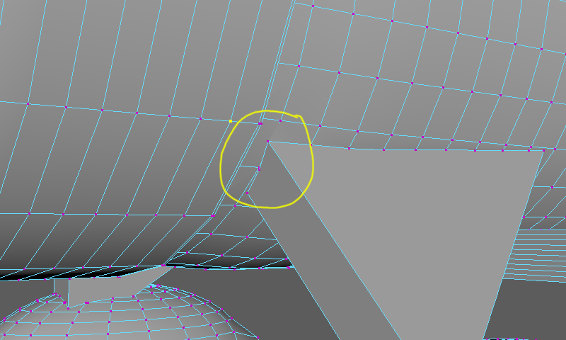

I am trying to export polygon models to an stl format for a 3D printer.  But parts of the model just disappear in the stl.  I am on a MAC running Mojave and MAYA 2019.  I have tried deleteing history, freezing transformation,  and triangulating to see if that would help.  All the objects have been unioned so they are a single unified mesh with no known errors.  I see there are issues from MAYA 2018, have these problems just continued in 2019?  If so are there any work arounds?
For example the biplane below just becomes the propeller and wheels, the plane itself disappears.
Thanks for you help

Hi!
STL export works fine here in Maya 2019.2 .
Please upload a scene-file.

mspeer
Hi!
Correct the vertex positions where the main body of the plane is connected to the frame of the wheels.
