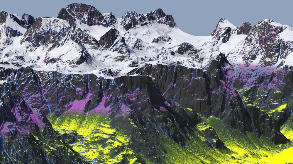

May not suite everybody's needs, but there's a ShaderFX solution. Should work in 2016 too.
ShaderFX Displacement and Tessellation, and Offset Bump Map
