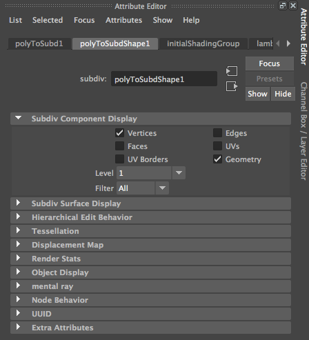

It appears that that workflow is not compatible with Viewport 2.0. Change your viewport renderer to Legacy Default Viewport and try again. (It's in the Renderer menu right at the top of your viewport.)
Also, once you have converted your object to a subdivision surface, make sure you have vertices enabled in the attribute editor as shown below...and before you do the "refine selected" command, right-click and make sure you are in vertex selection mode and you have selected the vertices.
It's kind of a flaky workflow...you may decide it's worth it to pay for a few months of a Mudbox subscription.

Thanx... again.
Works and i do have a mudbox subscription... thought why use 2 softwares when you can do it in one... better stick with mudbox then and hope they make it useful one day 😉
