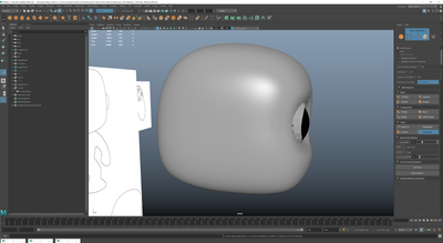

Ok so I've applied a Quad Draw to my model and saved it.
How would I go about editting the Quad Draw once I've left the Live and Quad Draw features?
Whenever I try to select the object, make it Live and then select Quad Draw, I can't edit my previous Quad Draw. It makes a completely new one. How do I select my old Quad Draw?
Thanks for any help in advance!
17,202 Views
pshwayka
Open your scene and make the background object live again.  Then open your outliner (Window->Outliner) and select the previous quad draw mesh.  It will probably be called something like polySurface1.  You should then be able to activate the quad draw tool and continue working on it.
that worked!! Thank you! 😀
