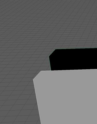

Hi.
I have drawn a curve like a rectangle, except I have a bevel on each corner.
I got a surface from it with the command Surfaces > Planar.
I duplicated the surface with the command offset.
I translated the surface a little bit.
I would like to join both surfaces with a loft command.
How should I proceed?
Please refer to the picture.
Thanks.

You need to select 2 curves for Loft.
Duplicate the curve before using 2 x Planar and 1 x Loft.

Thank you very much for reply.
I have drawn the curve, duplicated it, spaced th second one and applied the loft command.
I got what it is described in the attached picture.
I have like artefacts, like if the normals were wrong.
How can I solve it?
Thanks.

Hi!
It's impossible to say what's the problem here without a scene-file.
If the problem is relelated to normals than you need to change the direction of a curve or surface or inverse normals of polygons.
For me this looks like faces on top of each other what can also be caused by wrong curve or surface direction.
