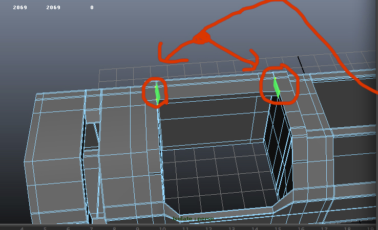

Hi guys, I'm having an issue with Maya. I am modeling a dash board for my spaceship. I am happy with the overall shape, so when I go in and insert some holding edges, I am getting a weird effect where maya is adding extra lines to my model. I have circle them below. I did some trouble shooting and now I am stuck. When I went to clean up, and nonmanifold option, I get the yellow dots vertices, which is where the error appears. Do anyone know how to solve this? thanks!! I am using the Maya 2014 Student EditionEdgeLoopTool.jpgNonManifoldGeometry_Issues.jpg

the yellow dots appear as result of you cleanup operation with "select matching polygons" checked. if i should bet i´d say you have faces inside your geo which create edges with more than 2 faces (see screenshot) where your marked vertices appear.
Hey, thanks for the reply. Actually it was extra faces hidden inside my model. I feel like an idiot sometimes, something so simple. But the stuff you posted are awesome! THey never taught us about the "Fix Quads" option in Maya at school, I feel like this will be a big help for me until I fully learn Maya. The tip about finding constrants is another great tip. I will be using these two tips alot in class. Thanks soo much for the respond and great tips on Maya!
