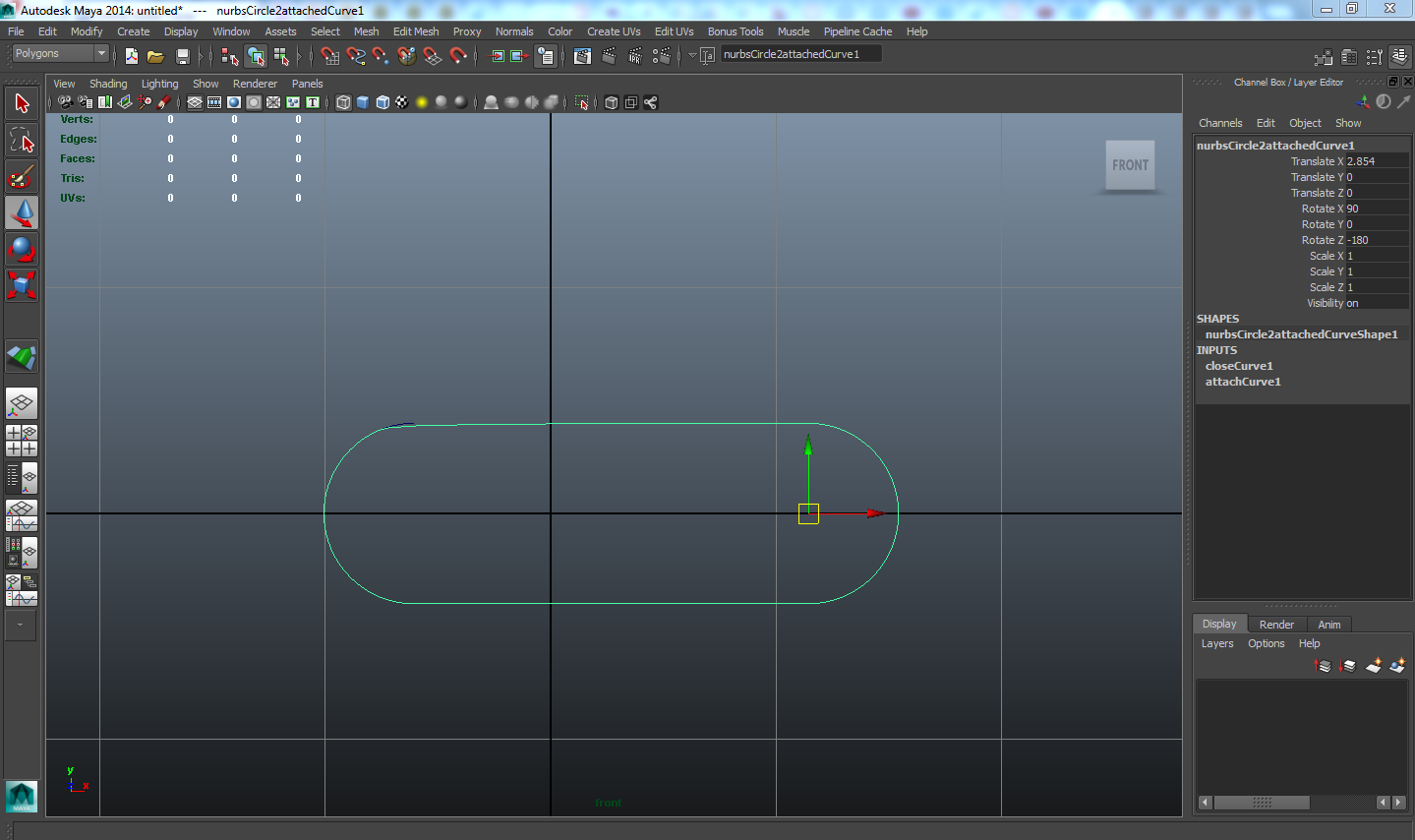

Hi, Maya community!
My problem is...
I want to get a perfectly round shape like thisIPhone_5.png(look at speaker)
But all I can to get is this terrible shape!
 Can someone explain me, why Maya cant to even connect two half-circles properly?

Anifex09
The shape you created will work. Just delete your history - select the top verts - goto the channelBox scroll open the CVs (click to show) tab - look for the value in the Y column that is different and change it to match the other Y values.

Oh, I forgot to said this is nurbs object
Message 4 of 8
Oops, I had't got it... Yea, now I trying your solution.
Message 5 of 8
Anifex09
if it is a nurb object created from the profile curve than just delete your nurb object - select your curve - goto Curve pulldown - Rebuild Curve Option - Set rebuild type to Uniform - set parameter range to 0 to 1 - set Keep only Tangents - Set number of spans to something like 40-60 - set degree to 3 Cubic - Click Rebuild - now try creating a nurbs surface with this profile.....
Message 6 of 8
This object created from two half-nurbs-circles (with sweep 180 degrees). Then i clicked "attach curves" (here i got this "bug" with form) and then clicked "Open/Close Curve".
P. S. I got something terrible when I tried to rebuild this curve 😞
Message 7 of 8
Thanks! I got a perfect round shape as I want! Thanks thanks thanks!
Message 8 of 8
Anifex09
So for the next time that you create this shape try this.
Create one Nurb Circle with the sweep angle set to 180 - duplicate the half circle and rotate it 180 degrees - Space the half circles apart - Goto Create EP Curve Option (set curve degree to 1 Linear) - make two lines connecting the two half circles (use the snap to curve constraint when creating the lines) - now select your two half circles and your two Ep Lines - goto the Edit Curves - Attach Curves Options - Set Attach method to Connect - Set Multiple knots to Remove - click attach
