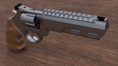

Trying to fix normals after changing edges from hard to soft and back again on a weapon cyclinder.
Its a 30 sec fix in 3ds Max , setting smoothing groups to 22 degrees after
selecting all faces and then weighted normals with smoothing groups.
In Blender I set edges to hard/soft as needed add a weighted normal mod, face&angle area.
In Maya I have no idea , been googling for some time to find a fix inside Maya

Hi!
Mesh Display -> Soften/Harden Edges
(Make sure the normals are unlocked.)

Thank you, getting the look I was after. Nice tools to adjust normals in Maya. But need to read more. Set all edges to soft then hardened them again and the result
is as it should be after unlocking norms

you went too far, a set angle of 30 or 40 should do it to keep the round surface soft but the bevels hard, looks like you just set Hard Edges .
Try again Set normal angle 30 or 40.

I did just that. Was just experimenting to learn how to get back to where the normals were when I started.
This is a low detail .obj from Fusion360, seeing if I can take this into Unreal Engine with very little in the way of changes and time. Changed a few hard edges and moved a few verts, made a few cuts here and there. But its mostly untouched. Imported into Blender to quickly applink into 3dCoat for UV . For a VR game
 Going to do a full retopo later.
