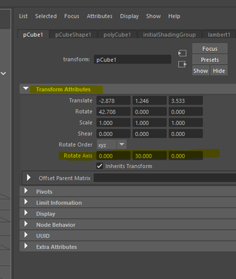

I want to rotate an object in the Object Axis by entering a value. All the values in the Channel Box seem to be for the World Axis. So how do a enter a value to rotate the object 30° in Y of the Object Gizmo? (see picture).

You could enter your object rotation values using the attribute editor instead of the channel box.
As you are correct, in that the channel box is relative to the world. But within Attributes--> Transform Attributes there is an object rotation field (screenshotted)
johnmkAP8T
Yes, that works. Thank You.
