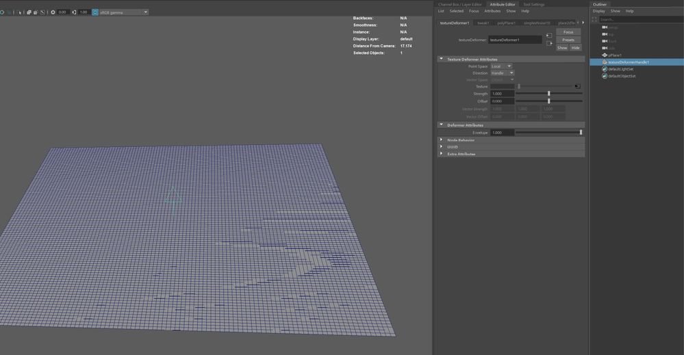

I am testing various procedural textures on a plane  to see how texture deformer woks and I can get noise, fractal, ocean to work but not simplex noise.
No matter what parameter I change (point space, direction etc) I don't see any change.
What am I doing wrong?

It works fine here, just increase the strength.

Hello @numan85,
I can understand why you may not see any changes with simplex noise.
When simplex noise is created as a deformer, the texture deformer point space is automatically changed to "local".
The other settings you were experimenting with were likely still classified under "UV" point spaces.
I'd suggest experimenting more with the texture deformer attributes, such as Direction and Vector Space, You will see the changes I think you are looking for. 🙂

Hi @numan85,
This is largely because Simplex Noise does not support UV Space, meaning you will not see a similar deformer structure, as with normal noise and other textures. I've attached an image showing that simplex certainly does do something, but to be honest it's not something I'd recommend for your purposes, and you will not see a similar effect.
Can I ask what your goal is with simplex noise, compared to the standard noise option? Perhaps we can figure out a modifier to assist you!
EDIT: I should mention in the image that this sphere has no other modifications done to it.

alec.andersenLP8AU
Hi @numan85,
A standard noise structure would definitely get you these results. However, if you need cellular noise, I'd suggest creating a cellular noise texture and supplying that directly once you have the parameters set up. Remember that any image file can be used as a UV space; a handy tool!  I'm sure there are other methods as well!

Yeah I ended up going the substance designer route to generate cell noise and import into Maya.
I am just surprised that simplex noise doesn't work even when using non uv space. What is the point of this node if it can't work on a trivial example. Is this a legacy node or something?

Hi!
Simplex Noise is a very special node as it does not suffer from UV repetition patterns, regardless of scale.
It's not a common texture node like most other nodes and because of this it has some limitations.
