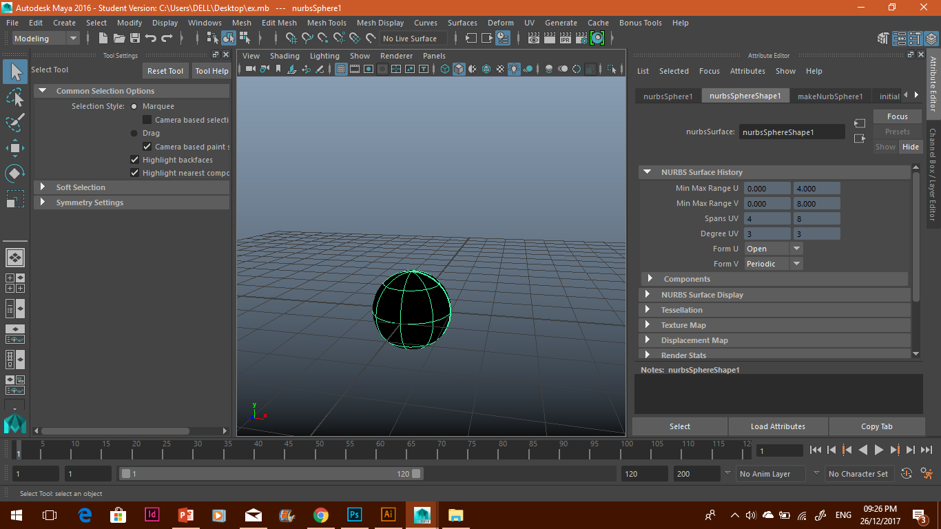

hello
when i import a 3d obj to maya scene all the faces turn to black when using all lights , can anyone help me ??
i tried to freeze transformations , reverse normals , cleanup & break connections ...... nothing worked 😞

1. Without any light and using "Use ALL Lights (...that are currently in the scene)" all objects are black in Viewport, you should not expect something different.
2. You don't need to export the lights in your scene if you don't want to! ???

Using Mode "Use All Lights" + having not a single light will result in black objects. That's normal, because 0 (no) lights will be used
So there are 2 solution:
A) Add at least one light to your scene, or
B) Change Lighting to "Use Default Lighting"
