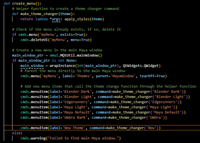

I've been working on a UI Tool for changing theme presets on Maya and was wondering if anyone would be interested in making some community made UI theme presets. I've made a couple of themes already that can be used as templates, you'll just need to change a few values to get what you want. I'll also be available to assist with any problems that may arise while i focus on fixing a few issue's with the code.
Please find the available presets as well as the project repository in the link below
Thank you.

Just to be clear, users make their own changes and new UI themes by playing around with the values in the existing qss files, right?  When we want to see our changes, how do we add our new theme to the list you have already that loads in the Themes drop down menu?
This is a great project.  So glad you decided to share this.
Aldanoah
@Meliko
To add a new theme you just have to add a new entry under line 62 of the UI Preset Loader script. The label can be whatever but the command has to have the actual name of the style sheet you made. The naming convention is "Name_stylesheet.qss" but you'll just need to enter the "Name" part minus the "_stylesheet.qss"
Changes you make won't update live so you'll have to save the style sheet then click on your theme in the drop down menu to view any changes.
