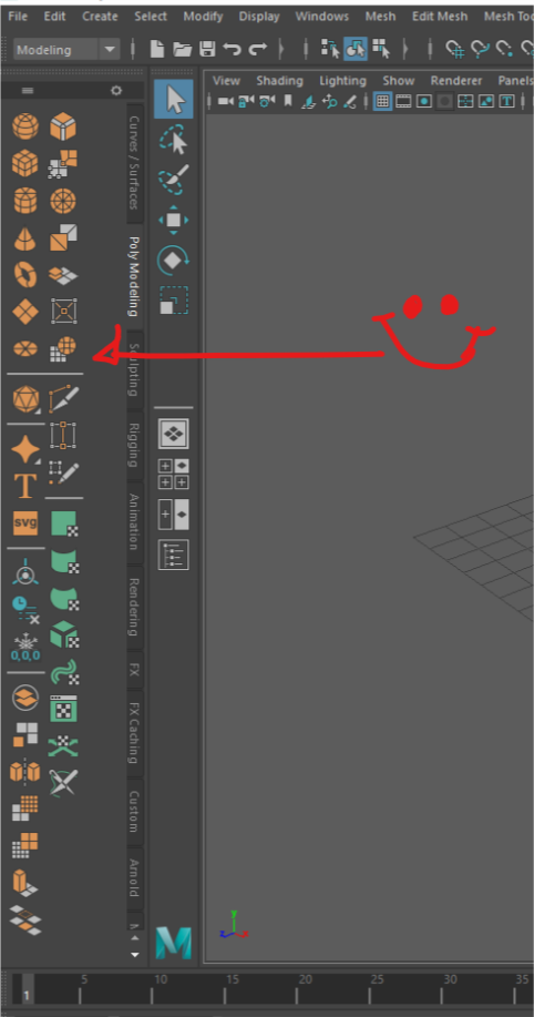

I'm happy to say you can now do this in the latest versions of the software. You can also make the shelf a square, have it floating on a second monitor, or whatever else you think would be useful.
And you can save different layouts withe the workspaces that are also shareable as simple files to others too.
