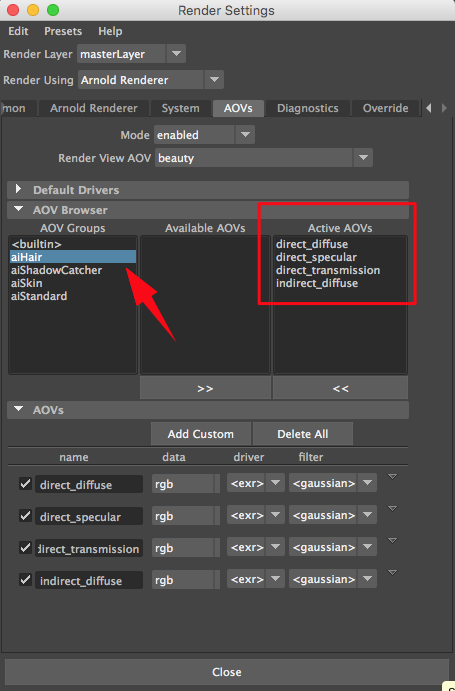

pshwayka
Open your Arnold render settings, and on the AOVs tab, click on aiHair in the AOV Groups column, then select all of the available AOVs for that selection and send them over to the Active AOVs column...then try your render again.

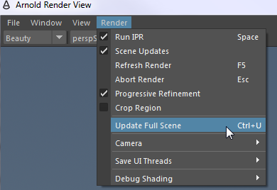

Michael_Todd
You have to press cntrl+u to force a full scene evaluation for IPR renders to pick up changes like that. The Maya renderview window has an otpion to force full scene evaluation with IPR by default in the render globals:
The arnold render view does not have this option, only the CNTRL+U to force the update.
