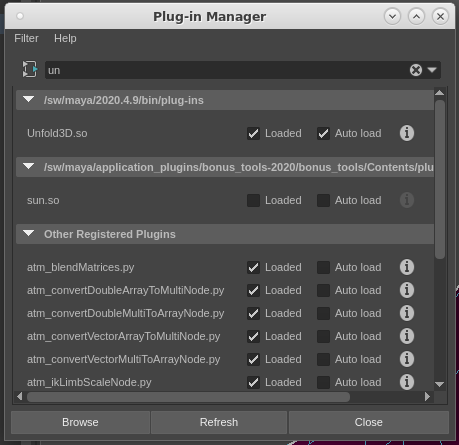

Hello everyone,
Hope this helps some of you, i was having the same issue but the i found out that my plugin unfold wasn't turned on.
that fixed my issue. you need to load the unfold3D , save your preferences, close maya and reopen it.Screenshot from 2022-06-16 11-14-34.png

Thank you so much, this did the trick. It's been driving me up the wall.
