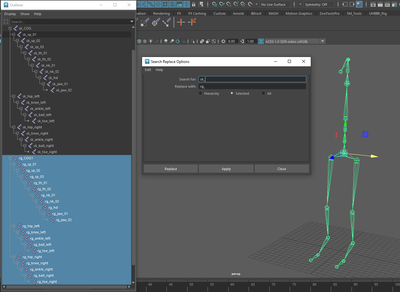

Below is an image from a simple file I created today using Mayas inbuilt tool. Nothing out of the ordinary.
Simple hierarchy duplicated and rename settings before rename edit. In the duplicated joints, I selected the sk_COG1 and then shift selected the sk_toe_right joint in the duplicated hierarchy to get the selection.
After renaming...
Some items are not renamed properly, some are out of sync.
As a test, I deleted the duplicated hierarchy and then duplicated the original again. This time, I selected the sk_toe_right joint (last joint in duplicated hierarchy) first and then shift selected the sk_COG1 joint and ran the rename tool again, which appears to have renamed the duplicates correctly.
So it appears there is some issue or discrepancy in the name/selection order. This is only a quick test though, more are underway.
