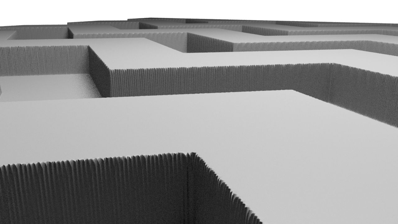

Hi everyone! I am working on a project nearing my deadline. I found various issues while applying displacement map in vray (I previously used displacement maps in organic models with no problems) with uneven displaced areas and edges and blotchy glitches. I used a simple plane uv unwrapped and even tried using vray displacement mods and also experimented with color/alpha gain but no fix. I am using vray 3.6. Please help me to fix this issue cause its eating my head and found no solution in online about it.

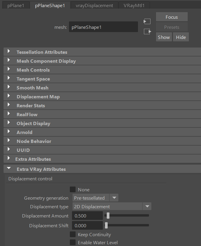

Hi, I tried replicating displacement using checker texture. Initially it looked similar to your screenshot, but I got better results when I changed the Displacement type to "2D Displacement" in Extra VRay Attributes for the shape node. I have included a scene file and couple of screenshots.

I'm glad it worked! As for beveling when using image map, first make sure you image is large enough (I tried using a 4K image), and then in extra VRay Attributes change Texture resolution to match image size, bump up the precision and reduce filter blur to some smaller value (I used 0.001 in this example). Check the attached screenshot.

Hi, I can see that in your GPU render settings you have "Resize all textures" on, with the GPU texture size set to 512, so I think VRay is turning your 4K textures to 512px, which may be causing the little lines visible in Test3 render. CPU rendering is supporting more features so maybe you won't be getting that error message if you try it (I tried using CUDA on my end, but the displacement didn't even render). Also, I'm not sure if you have added Displacement Control attribute to the shape node of your mesh? There are some additional quality controls in there.

For a cleaner displacement of vertical shapes like this, increase the subdivisions on your plane to a higher number, use a 32 bit or 16 bit image for displacement and match the resolution under Texture resolution.
I've also lowered the edge length.
2D displacement is not supported in CUDA....render in the CPU
