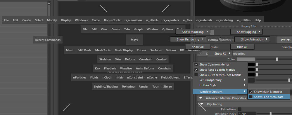

Hey, I'm very new to Maya and recently got into texturing. last time I opened up the hypershade window, my view and other buttons up the top were missing and my view for my models were gone. Is there any way to bring them back. See the picture to understand what I mean.

Step 1: Get your menu bar back.
Simply press "Shift + m".
If that does not work, use the following steps.
  • Open the hotbox by holding down the spacebar.
  • Click-and-hold on "Hotbox Controls".  (It's on the right.)
  • Drag down to the "Window Options" menu, and then onto the "Show pane menubars" item.
  • Release the mouse on "Show pane menubars" to check the box.
Step 2: Get your model viewer back.
On the menubar, go to the "Window" menu and select "Material Viewer..."
